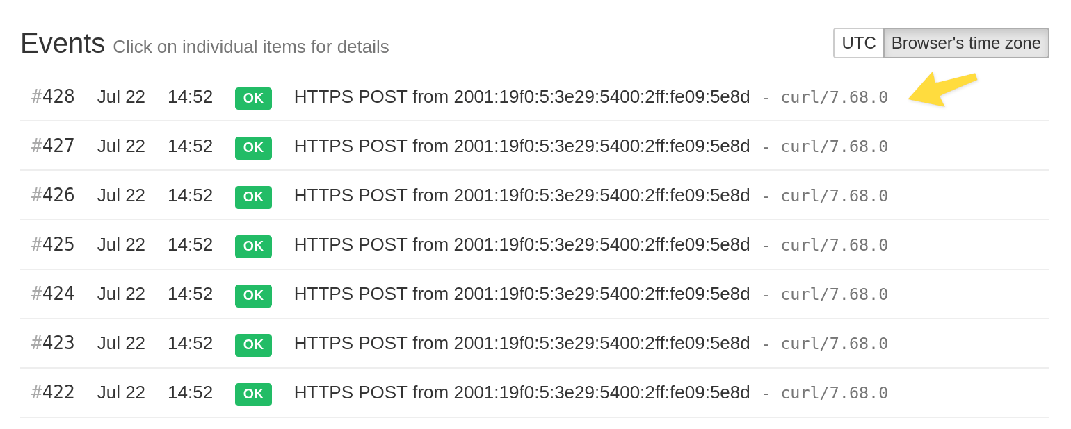

In the check's details page, Events section, click on individual events to see full event details, including the captured log information.
The Events section
