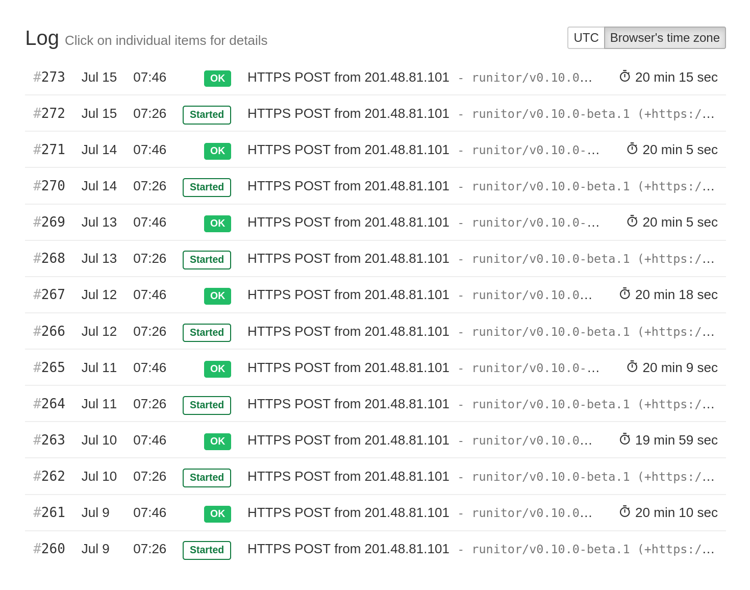

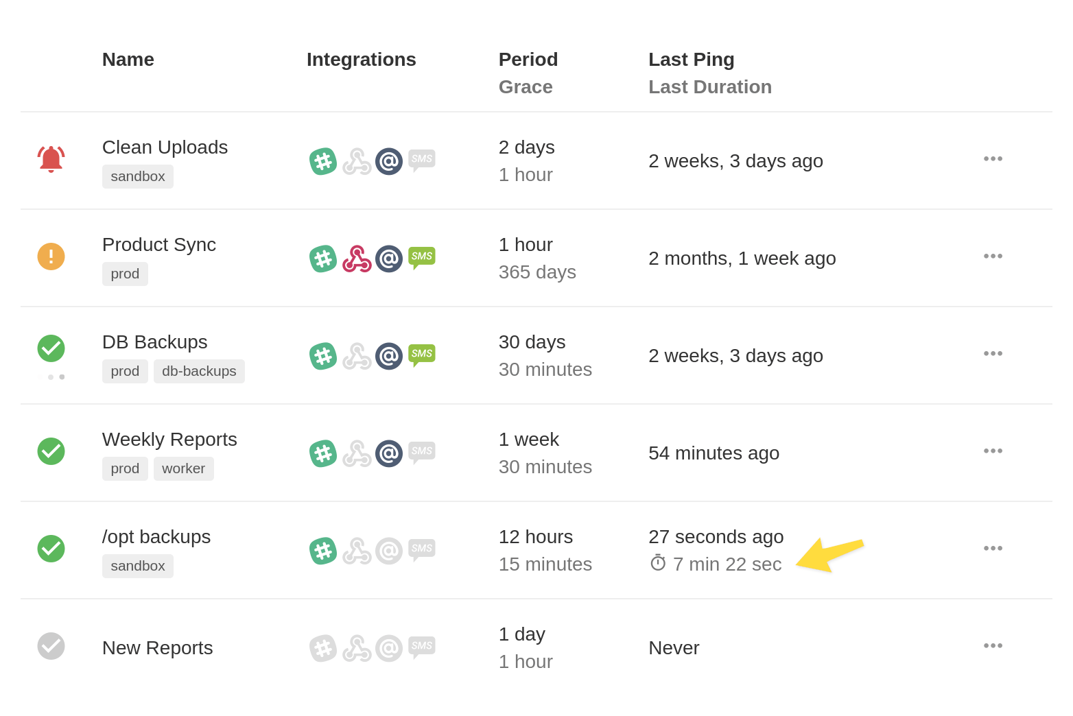

Viewing Measured Run Times
When Netwrix Healthchecks receives a "start" signal followed by a regular ping or a "fail" signal, and the two events are less than 72 hours apart, you will see the duration displayed in the list of checks. If the two events are more than 72 hours apart, they are assumed to be unrelated, and the duration is not displayed.
List of checks with durations
You can also see the durations of the previous runs when viewing an individual check:
Log of received pings with durations

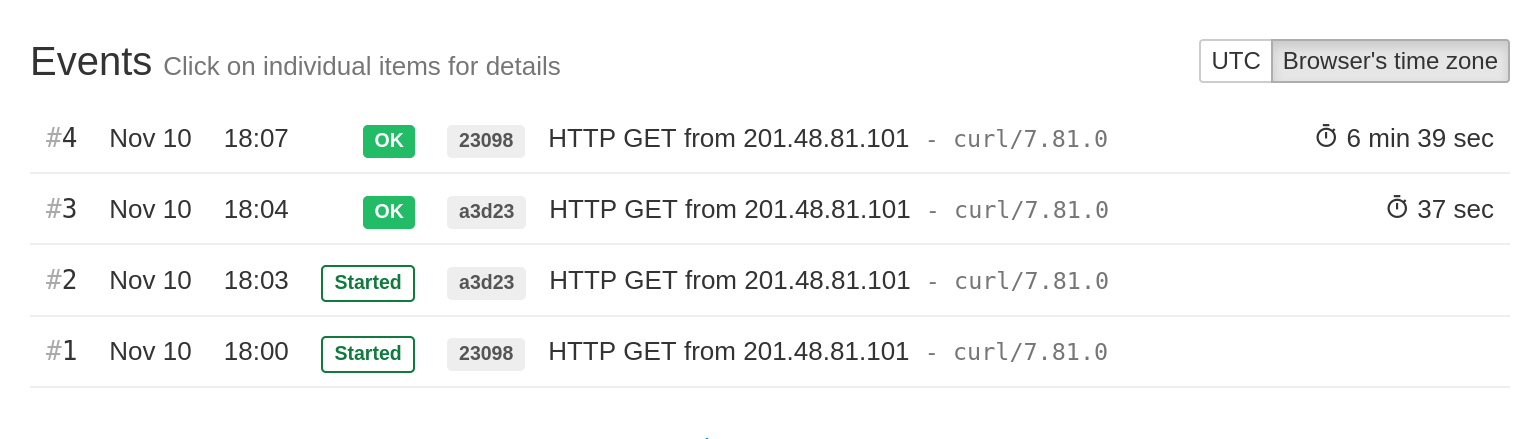

If the client specifies run IDs, Netwrix Healthchecks will display them in the "Events" section in a shortened form:
Log of received pings with run IDs and durations
Also, note how the execution times are available for both "success" events. If the run IDs were not used in this example, the event #4 would not show an execution time since it is not preceded by a "start" event.
Alerting Logic When Using Run IDs
If a job sends a "start" signal but does not send a "success" signal within its configured grace time, Netwrix Healthchecks will assume the job has failed and notify you. However, when using Run IDs, there is an important caveat: Netwrix Healthchecks will not monitor the execution times of all concurrent job runs. It will only monitor the execution time of the most recently started run.
To illustrate, let's assume the grace time of 1 minute and look at the above example again. The event #4 ran for 6 minutes 39 seconds and so overshot the time budget of 1 minute. But Netwrix Healthchecks generated no alerts because the most recently started run completed within the time limit (it took 37 seconds, which is less than 1 minute).
