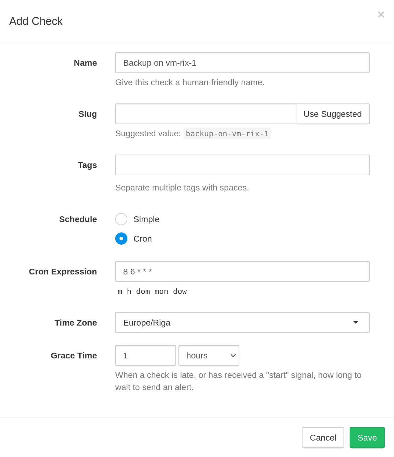

To monitor it, first create a new Check in your Netwrix Healthchecks account:
The "Add Check" dialog
After creating the check, copy the generated ping URL , and update the job's definition:
# run backup.sh, then send a success signal to Netwrix Healthchecks
8 6 * * * /home/me/backup.sh && curl -fsS -m 10 --retry 5 -o /dev/null http://localhost:8000/ping/your-uuid-here
The extra curl call lets Netwrix Healthchecks know the cron job has run successfully. Netwrix Healthchecks keeps track of the received pings and notifies you as soon as a ping does not arrive on time.
